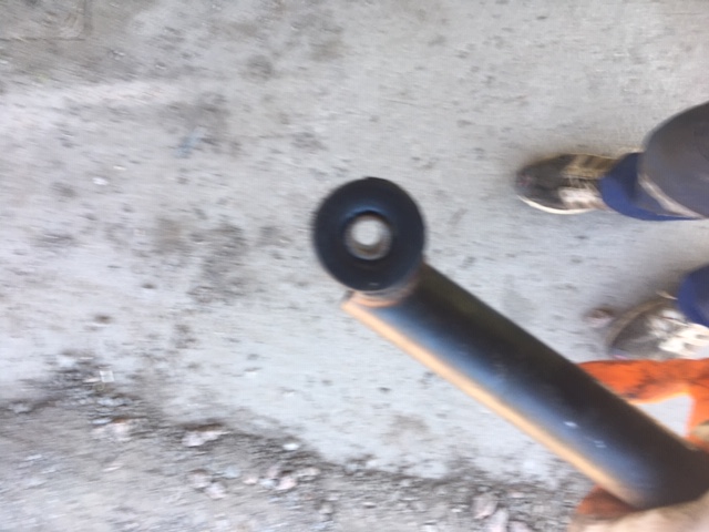

When revising the front axle suspension, I found serios problems.
Almost all rubber bushings in the upper and lower supports of axle looks like that:
I can not explain this fact :-( Maybe, they shifted themselves due to critical worn, may be the previous owner tried to replace them and pressed them wrong - I don't know :-( But I have to repair that definitely.

The main question is: is it possible to montage these new bushings instead of old?
The second question is: I have only 4 new bushings. At this moment I can't order neither 291407085 nor 281505181 bushings ((
May be anyone know the partnumber of an alternative suitable rubber bushings?
I'll be greateful for any information and help

Hello .
Rubber on the main are différent up and down .
I don't remember but up or down is more tender .
May be for the move front axle to start and stop LT .
Bruno

Beitragvon serega198 » Samstag 9. Juli 2022, 01:22
Hi, Bruno.
I know about the difference, thank you. But I had no choice. It's impossible to order original 291407085 and 291407085A :-( I created this topic in order to find an adequate replacement. But no one knows or no one answers.
I didn't find any other suitable rubbers. Perhaps now the suspension does not work quite right, but it is much better than it was.

Beitragvon deepurple » Montag 11. Juli 2022, 15:07
Yes, i think .
Different rubber's quality ,ok, but better with another news rubbers that it was .
Sometimes we don't have choice .
